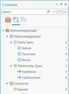

An investigation's Contents pane has at least two tabs. The types of entities and relationships for which instances exist in the knowledge graph are listed on the By Type tab Investigation; this tab is selected by default.
List of entity and relationship types in use on the By Type tab
The Data Model tab lists all types of entities and relationships defined in the knowledge graph's data model, including types for which no instances exist yet in the graph.
List of all entity and relationship types defined in the knowledge graph on the Data Model tab

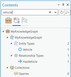

If you are working with a complicated knowledge graph, you can search for specific entity and relationship types with the Search text box at the top of the Contents pane. As you type, the list of entities and relationships is filtered to include only types whose names match your text.
Search for specific entity and relationship types by name in the Contents pane.

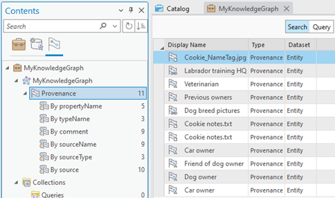

View provenance records

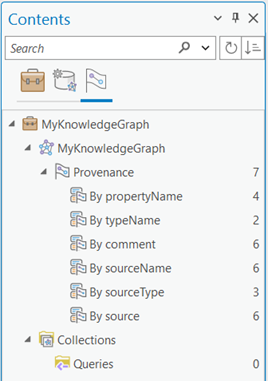

If provenance is enabled for the knowledge graph, the Contents pane also has a Provenance tab that allows you to explore provenance records. Each provenance record defines the source of a property value. Each property of an entity or relationship can be associated with many provenance records.
Explore provenance records on the Provenance tab.
You can explore provenance records by selecting the headings in the Contents pane. The heading names are determined when the knowledge graph is created, based on how provenance record properties are configured. When you click a heading, a summary of the values associated with each provenance record's property is listed in the investigation view.
  1. On the Provenance tab in the Contents pane, click the Provenance heading in the list.
    The total number of provenance records in the knowledge graph is listed next to the heading.
    By default, the first 1,000 provenance records are listed in the investigation view. The current number of provenance records listed in the investigation is indicated in the status bar. Basic properties for each provenance record appear in the list.
    Provenance records are listed in the investigation view.
    Each provenance record is identified using the value in the Display Name column. It shows the record's sourceName property value. The icon next to the display name indicates whether the source associated with the provenance record is a document , a URL , or text .

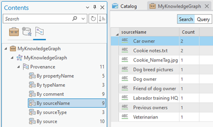

  2. Click a heading associated with one of the provenance record's properties such as the By sourceName heading .
    The following headings are available by default.
    By propertyName
    When this heading is selected, the name of each entity or relationship property with a provenance record is listed in the investigation, along with a count of the provenance records associated with that property. The default name for this provenance record property is propertyName. The total number of properties associated with provenance records is listed in the Contents pane next to the heading.
    By typeName
    When this heading is selected, the name of each entity type or relationship type with a provenance record is listed in the investigation, along with a count of the provenance records associated with that type. The default name for this provenance record property is typeName. The total number of entity and relationship types associated with provenance records is listed in the Contents pane next to the heading.
    By comment
    When this heading is selected, all comments are listed in the investigation along with a count of the provenance records associated with that comment. The default name for this provenance record property is comment. The total number of unique comments in all provenance records is listed in the Contents pane next to the heading.
    By sourceName
    When this heading is selected, all source name values are listed in the investigation, along with a count of the provenance records associated with that source name. The default name for this provenance record property is sourceName. The total number of unique source names in all provenance records is listed in the Contents pane next to the heading.
    By sourceType
    When this heading is selected, all source type values are listed in the investigation, along with a count of the provenance records associated with that source type. The default name for this provenance record property is sourceType. The total number of unique source types in all provenance records is listed in the Contents pane next to the heading.
    By source
    When this heading is selected, all source values are listed in the investigation, along with a count of the provenance records associated with that source. The default name for this provenance record property is source. The total number of unique sources is listed in the Contents pane next to the heading.

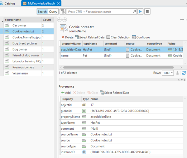

    The values associated with each provenance record's property are listed in the investigation view, along with a count of the provenance records associated with the property.
    All source name values for all provenance records are listed in the investigation.
  3. Click a property value in the investigation view's contents list.
    By default, the first 1,000 provenance records associated with the property value are listed in the details panel. The current number of provenance records listed in the investigation view is indicated under the list.
    Provenance records associated with a specific property value are listed in the details panel.
  4. Click one or more provenance records in the list at the top of the details panel.
    The properties associated with the selected records are listed at the bottom of the details panel. If many provenance records are selected, values are displayed for each property if all selected records have the same value. Text such as (Different Values) appears if any selected provenance record has a different value for a given property.

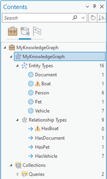

A warning symbol appears in the investigation's Contents pane to indicate an entity type or a relationship must be updated. Similarly, a warning symbol appears in the investigation's details panel to indicate a property is out of sync.
The Boat entity type and the HasBoat relationship type have a warning symbol in the Contents pane.
On the Investigation tab, in the Tools group, click Synchronize Data Model to update the information maintained by ArcGIS Knowledge about the data and the data model in your Neo4j database. A notification appears indicating the process has started.
