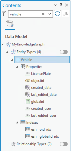

If you are working with a complex knowledge graph, you can search for specific entity and relationship types with the Search text box at the top of the Contents pane. You can filter your search by clicking filter and selecting a filter option. Filter options are described below:
  • By Type—Filter your search by entity types and relationship types.
  • By Properties—Filter your search by properties of entity types and relationship types.
  • By Data Type—Filter your search by property data types.
As you type, the list of entities and relationships is filtered to include only types whose names match your search term. When filtering by data type, click the search field and select a data type from the drop-down list.
Search for specific entity and relationship types by name in the Contents pane.
