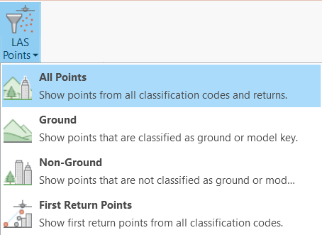

A lidar pulse can be reflected from one or many features and can therefore return more than one laser pulse. You can use these separate laser pulse returns to display the lidar data referenced by the LAS dataset. The most common filters are Ground and Non-Ground, meaning ground laser returns and feature laser returns, respectively. Being able to separate out lidar data based on different laser returns allows you to analyze and visualize lidar data quickly and efficiently for various applications.
The LAS Points filters drop-down menu provides a quick way to access common lidar filters. There are several other options available in ArcGIS Pro to filter lidar data referenced by the LAS dataset. Use LAS Filters on Layer Properties for more advanced point filter options.
Choose from any of the following lidar point filters:
LAS point filters available on the Appearance tab
Point or surface filter
Description
All Points
Use all the lidar points to display the LAS dataset.
Ground
Use only the lidar points flagged as ground points to display the LAS dataset.
Non-Ground
Use all the lidar points that are not flagged as ground points to display the LAS dataset.
First Return
Use only first-return lidar points to display the LAS dataset.

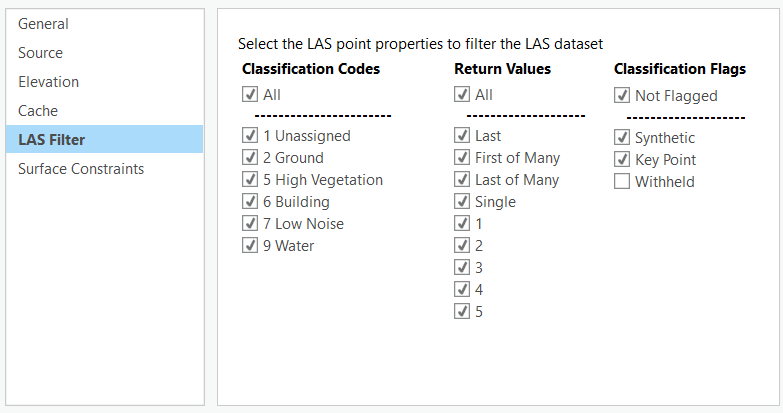

  1. Click the LAS Points button from the Filters group to open the LAS Filters on the Layer Properties.
  2. Click the appropriate check boxes to display the desired LAS dataset filter options.
The LAS Filter tab on the Layer Properties dialog box
Point filters
Description
Classification Codes
Every lidar point that is postprocessed can have a classification that defines the type of object that has reflected the laser pulse. Lidar points can be classified into a number of categories, including bare earth or ground, top of canopy, and water. The different classes are defined using numeric integer codes in the LAS files.
Return Values
An emitted laser pulse can have up to five returns depending on the features it is reflected from and the capabilities of the laser scanner used to collect the data. The first return will be flagged as return number one, the second as return number two, and so on.
Classification Flags
When a classification is carried out on lidar data, points may fall into more than one category of the classification. Classification flags are used to provide a secondary description or classification for lidar points. For example, a lidar return from water may need to be removed from the final output dataset, but it still should remain and be managed in the LAS file as a collected lidar point.
With LAS version 1.0, a lidar point could not simultaneously maintain two assigned classification attributes. In later versions (LAS 1.1, 1.2, 1.3, and 1.4), classification flags could be used to solve this problem.
Synthetic, Overlap, Key Point, and Withheld flags can be set for each lidar point. These flags can be set along with the classification codes.
