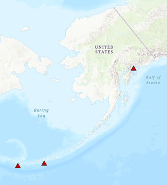

Free-form text example
If you are reviewing news articles about earthquakes in Alaska and want to see each location that is mentioned in an article on a map, the sample input text below can be copied and pasted directly into the pane.
Input text
Alaska averages 100 earthquakes a day. The tectonics of the region are dominated by the interaction of the Pacific and North American plates. This interaction has accounted for three of the largest recorded earthquakes in history. The largest, measuring 9.2 on the Richter scale, occurred in the Prince William Sound (60.91°N, 147.34°W) on March 28th, 1964. The second largest Alaskan earthquake, measuring 8.7, occurred on February 4th, 1965, near the Rat Islands (51.25°N, 178.72°E). The third, measuring 8.6, occurred on March 9th, 1957, near the Andreanof Islands (51.50°N, 175.63°W).
Output features
Once the locations of the three earthquakes have been extracted from the input text, the output feature class appears in the Contents pane, and the points are visible in the active map.
Extracted earthquake locations in Alaska
By default, any dates found in the input text that are within a relatively recent time period are also extracted and recorded in the attribute table of the output feature class. However, the dates in the input text above fall outside the default date range.

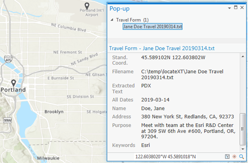

Semistructured text example
In addition to recognizing spatial coordinates, custom locations can be defined that associate a place with a spatial coordinate. For example, if the word Portland is found anywhere in a document, a point representing a location in the city can be associated with that word. Similarly, if an airport code is found, a point representing the airport's location can be associated with that code.
Some documents have a certain amount of structure. If you have a folder full of travel forms, information can be extracted from them and stored in custom attributes in the output feature class's attribute table. For example, with a document containing the input text below, custom attributes can be defined that extract text following the labels Name:, Address:, and Purpose of travel:. Later, the attributes can be processed using other tools available in ArcGIS Pro.
Input text
Address: 380 New York St, Redlands, CA, 92373
Date: 2019-03-14
Destination: PDX
Purpose of travel: Meet with the team at the Esri R&D Center at 309 SW 6th Ave #600, Portland, OR, 97204.
Output features
Once the custom locations in Portland have been extracted from the input text, the output feature class appears in the Contents pane, and the points are visible in the active map. Click features to explore the information extracted from the document. For this example, dates are extracted and stored in the attribute table. Custom attributes are also used to extract text from the end of a label to the end of the line, and store that content in fields representing the name and address of the person traveling and the reason for the trip. An additional custom attribute is used to locate any keywords that exist in the document and store them in another field.
Extracted locations in Portland
The contents of the Address field in the output feature class's attribute table can be geocoded using other tools; it is not geocoded automatically. Similarly, the address stored in the free-form text describing the purpose of the trip is not automatically identified as an address and geocoded.
