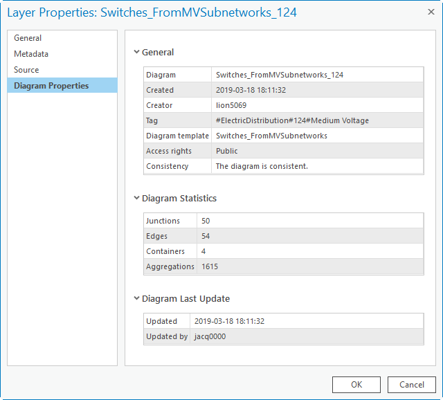

  4. In the Contents pane, right-click the diagram layer and click Properties.
    The Layer Properties dialog box related to the diagram layer appears.
  5. Click the Diagram Properties tab.
    Diagram Properties tab example
Diagram Properties details
The following sections are included on the Diagram Properties tab: General, Diagram Statistics, and Diagram Last Update.
General
The General section includes information about the diagram creation, its template, and its state:
  • Diagram—The diagram name.
  • Created—Its creation date.
  • Creator—The diagram owner.
  • Tag—The diagram's tags. This information only displays for stored diagrams.
  • Diagram Template—The diagram template on which the diagram is based.
  • Access Rights—The access permissions set on the diagram.
  • Consistency—The consistency status of the diagram.
Diagram Statistics
The Diagram Statistics section displays statistics on the following diagram features:
  • Junctions—The number of junctions represented in the diagram
  • Edges—The number of edges represented in the diagram
  • Containers—The number of containers represented in the diagram
  • Aggregations—The number of aggregations in the diagram
Diagram Last Update
The Diagram Last Update section displays information about the last diagram update:
  • Updated—The date of the last diagram update
  • Updated By—The user who last updated the diagram
