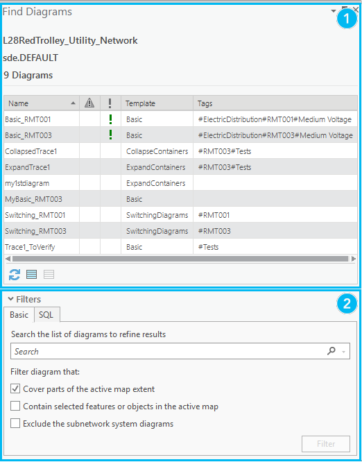

Get started with the Find Diagrams function
In both cases, the Find Diagrams pane appears and has two main sections: Diagrams and Filters.
The two sections of the Find Diagrams pane labeled 1 and 2
  • The Diagrams section, number 1 in the image above, lists the diagrams returned from the search.
  • At the bottom of this section is a row of three buttons:
    • Refresh Refresh
    • Select All Diagrams Select All
    • Clear Selection Clear Selection
  • The Filters section, number 2 in the image above, allows you to filter the diagrams returned in the Diagrams section.
When the Find Diagrams pane appears, the default active tab in the Filters section is Basic.

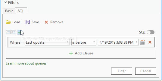

Find diagrams using SQL expressions
To search diagrams using an SQL expression, use the SQL tab in the Filters section.
SQL tab with default content
  1. Click the SQL tab in the Filters section of the Find Diagrams pane.
  2. Click New expression to begin building a query.
    1. Select a field, an operator, and a value or field to evaluate against.
      For example, you can select the Last update field to search for diagrams that have not been updated for a week, a month, and so on.
      Building a query
    2. Click Verify the SQL expression is valid .
    3. To combine that clause with another one, click Add Clause , select the exclusive (And) or additive (Or) operator, and provide the new clause.
    4. Click Apply when you finish with the clause or clauses.
      All the diagrams related to the utility network or trace network that verify the specified query display in the Diagrams section.

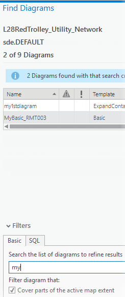

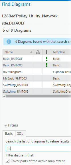

Additionally, you can dynamically refine the list of diagrams found in a search by typing a keyword in the Search the list of diagrams to refine results text box.
Search function in the Find Diagrams pane
The list is filtered in real time and includes only diagrams with names containing the specified character, string, or keyword.
The following images show the diagram list filtered for diagrams with names that contain the letter m (first image) and the string my (second image):

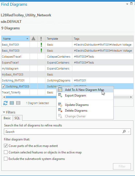

Open, update, export, or delete diagrams or change their ownership
You can open, update, export, and delete diagrams or transfer them to another owner using the commands in context menus that display when you right-click the diagram items.
Diagram commands in context menus from the diagram items in the Find Diagrams pane
The Delete Diagrams command , Update Diagrams command , and Change Owner command are enabled when one or several diagram items are checked in the list, since the related Delete Diagram, Update Diagram, and Change Diagrams Owner geoprocessing tools can run on multiple diagrams.
However, the Export Diagram command and Add To A New Diagram Map command are unavailable when multiple diagram items are checked in the list.
In addition, the Change Owner command is available only when the following conditions are met:
  • The diagram layer or network layer data source in the active map from which the Find Diagrams pane opens is from a utility or trace network in a file or mobile geodatabase, or a database connection to a utility or trace network in an enterprise geodatabase.
  • When working with a utility or trace network in an enterprise geodatabase, the user currently connected to the portal is the network owner.
The Update Diagrams command is unavailable in the context menus when using a database connection or, in the case of a utility network, when there is a subnetwork system diagram selected among the checked diagram items. Such a diagram cannot be updated using the Update Diagram tool.
The Delete Diagrams command is also unavailable for these subnetwork system diagrams unless you are connected to the portal as the utility network owner.
