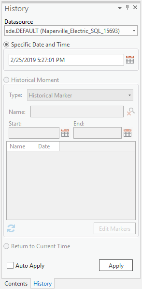

  5. Connect to the specific moment:
    1. Right-click the data source and click Change Moment.
    2. In the History pane that appears, use the Specific Date and Time or Historical Moment control to specify the moment.
      Connect to a specific moment.
    3. Click Apply.
    4. Close the History pane.
