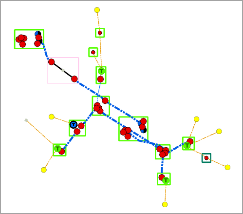

The graphics below show a sample diagram before and after applying the Compression layout:
Sample diagram before applying the Compression layout

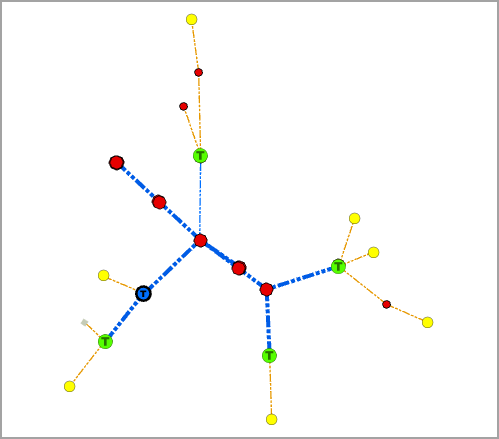

Here is the diagram layout after applying the Compression layout.
Sample diagram after applying the Compression layout

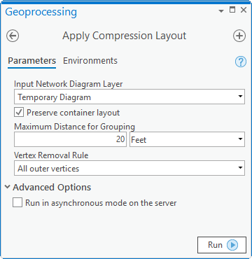

Compression layout parameters
Apply Compression Layout parameters
The sections below clarify the Compression diagram layout main parameters.
