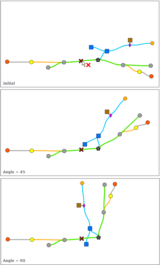

A barrier is positioned on the sample diagram:
Setting a barrier
The next image shows the sample diagram after applying the Rotate Tree layout:
Sample diagram after applying the Rotate Tree layout

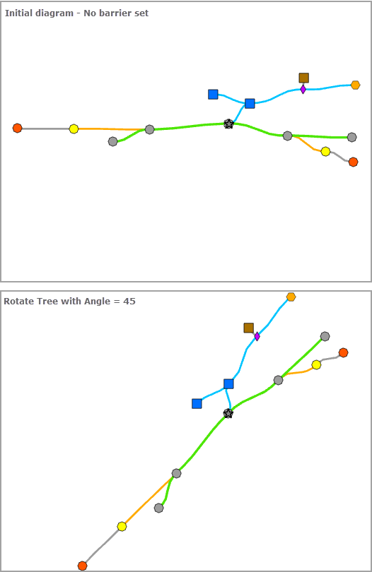

If the Rotate Tree layout requires at least one pivot junction to process, it can run without setting any barrier, such as in the sample below:
Rotate Tree sample result without barrier

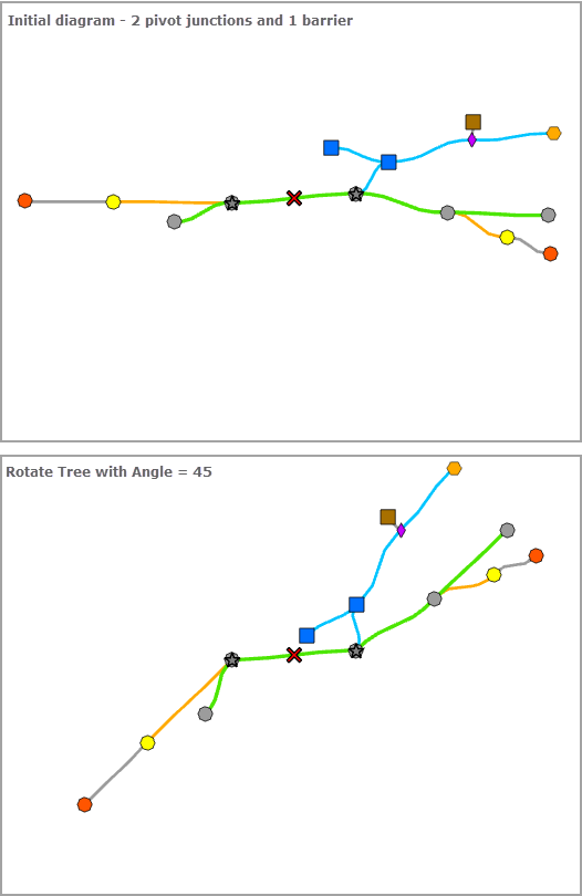

In addition, several pivot junctions can be set on the diagrams, such as in the following example:
Rotate Tree with two pivot junctions and one barrier

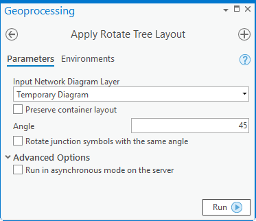

Rotate Tree layout parameters
Apply Rotate Tree Layout parameters
The sections below clarify the main Rotate Tree diagram layout parameters.
Preserve container layout
Most of the layout algorithms work with the Preserve container layout option. When this option is checked, it allows you to control the algorithm application so it runs on the top graph of the diagram. When this option is not checked, the algorithm is applied to both content and noncontent features in the diagram.
Learn more about the Preserve container layout option
Angle
This parameter is used to set the angle in degrees that will be used to rotate the tree:
Rotate Tree—Angle

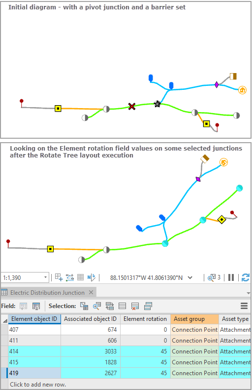

Rotate junction symbols with the same angle
Each diagram junction is stored in its junction feature class with a rotation system field which label is "Element rotation" and whose value is zero by default. The Rotate junction symbols with the same angle option specifies whether the specified Angle value must be added to the current value of the rotation field for each processed diagram junction.
  • Checked—The specified Angle value will add to the current value of the rotation field for each processed diagram junction.
  • Unchecked—The rotation field value will not change during the layout process. This is the default.
Tip:
The Rotate Tree layout is the only layout that edits the rotation field when it runs with the Rotate junction symbols with the same angle option checked. Then, to get your diagram junctions to automatically display with rotated symbols according to this rotation value at the end of the layout process as in the graphic below, you must set up the diagram layer definition accordingly.
Learn more about displaying diagram junctions with rotated symbols according to the rotation field values
Rotate Tree—Rotate junction symbols with the same angle
