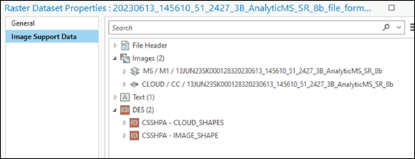

Multisegment NITF data in the Image Support Data pane
This example shows the contents of multisegment NITF data in the Image Support Data pane. Data courtesy of Maxar Technologies.

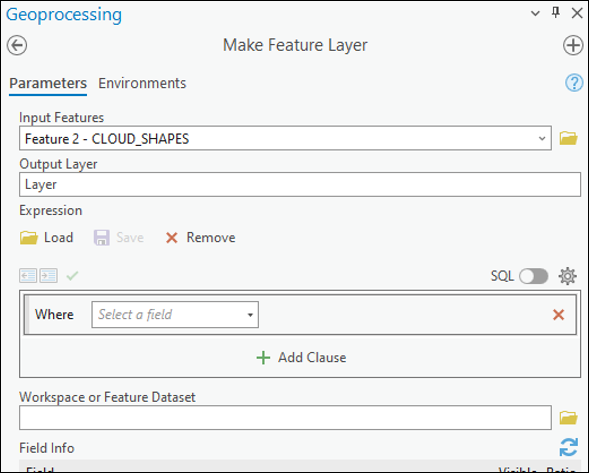

NITF subdatasets are also supported as input to relevant geoprocessing tools and raster functions through direct use of tools, models, processing chains, or scripts using the geoprocessing framework.
Input feature layer
An example of an input feature layer is shown. Data courtesy of Maxar Technologies.

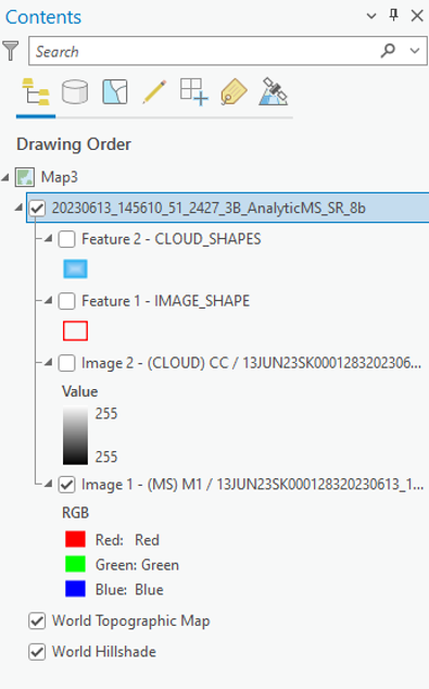

The NITF layer provides support for visualizing the contents of multisegment image segments in an NITF file containing displayable image information. Each image segment contains a single image consisting of one or more bands of data.
Multisegment image information
Multisegment image information is shown. Data © 2023 Planet Labs PBC.

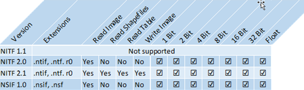

The following table shows the NITF format types and the corresponding functionality associated with NSIF 1.0, NITF 2.0, and NITF 2.1:
NITF read and write summary

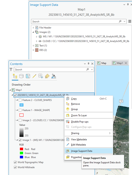

You can use the nonmodal Image Support Data pane to explore, search, access, and export NITF ISD. To access the Image Support Data pane, right-click the NITF layer in the Contents pane and click Image Support Data. The Image Support Data pane for the layer appears.
Detailed information about Tagged Record Extensions (TRE) or Data Extension Segments (DES), which are unique to the NITF file format, can be accessed by hovering over the specific TRE or DES of interest in the main body of the ISD viewer, and clicking the text button associated with the specific TRE or DES.
NITF Image Support Data pane
The NITF Image Support Data pane is shown. Data © 2023 Planet Labs PBC.

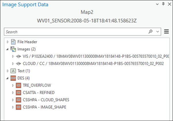

Raster dataset properties
To access the ISD, in the Catalog pane, right-click the NITF file and click Properties to open the Raster Dataset Properties dialog box.
NITF Raster Dataset Properties dialog box
The Raster Dataset Properties dialog box is shown. Data © 2023 Planet Labs PBC.
