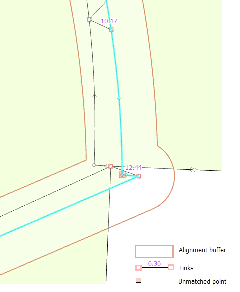

Alignment links
Links can be generated between matching points of selected parcels and adjacent parcels that lie within the alignment buffer.

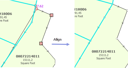

Alignment snap tolerance
Unmatched points of selected parcels are snapped to adjacent lines if the points lie within the snap tolerance.
