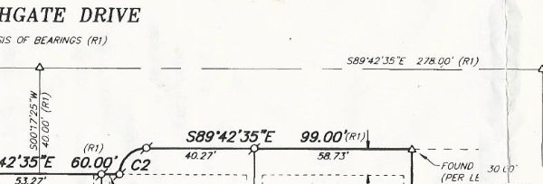

If there is a basis of bearing line stated on your record document, and you can digitize the same line on the map, you can interactively derive the ground to grid correction. A record document states a basis of bearing when all the bearings on the record document are based on the bearing of a designated line. For example, the basis of bearing may be the line between two physical monuments. In the record document below, the dimensions of the road centerline between two monuments is a basis of bearing line. The dimensions of the line are S89°42'35"E and 278 feet.
Basis of bearing
The basis of bearing is the direction of the line between two monuments.

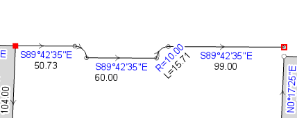

In the example below, a line is traversed between two existing points in the parcel fabric without a ground to grid correction applied. The traversed line does not close or end on the expected endpoint because a ground to grid correction has not been applied.
A traversed line without a ground to grid correction
