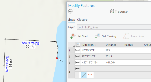

Digitize a traverse polyline
Traverse courses may follow natural features such as rivers or coastlines. In these cases, the traverse line is digitized as a polyline along the natural boundary and dimensions are not entered.
To digitize a natural boundary for a traverse course, follow these steps:
  1. Click the Line tool beneath the traverse grid and digitize a single polyline.
    Tip:
    Ensure that the line feature template uses the Line tool as well as the 2-Point Line tool .
  2. When the digitized polyline is complete, right-click the map and click Finish to create the traverse course.
    A single row is created in the traverse grid containing dimensions for the straight line between the start point and endpoint of the digitized polyline. These generated dimensions are displayed in angle brackets, for example, <S0°18'01"W> and <61.06>.
    Parcel traverse with a natural boundary
  3. To continue entering regular traverse courses after a natural boundary course, click the 2-Point Line tool beneath the traverse grid and continue entering traverse dimensions.
    The 2-Point Line tool ensures that single, two-point COGO-enabled line features are created for nonnatural boundary traverse courses.

Generated dimensions
When using edit tools to digitize traverse lines, dimensions are generated from the digitized line geometry and added to the COGO fields on the traverse grid. Dimensions generated from line geometry are displayed in angle brackets, for example, <N7°53'54"W> and <136.77>.
Generated dimensions are not labeled on the map or stored in the COGO fields on the line feature class. To label and store a dimension, click the field on the traverse grid, edit the dimension if necessary, and press Enter. The angle brackets are removed and the dimension is stored in the line's COGO fields.
Digitizing multisegment lines using tools such as Line and Trace adds a new single row to the traverse grid for the entire polyline. Dimensions are generated for the straight line that's between the start point and endpoint of the polyline, and they are populated in the Direction and Distance fields on the traverse grid.
Tip:
When digitizing with the 2-Point Line tool, you can edit the generated dimensions in the traverse grid to store and label them.
