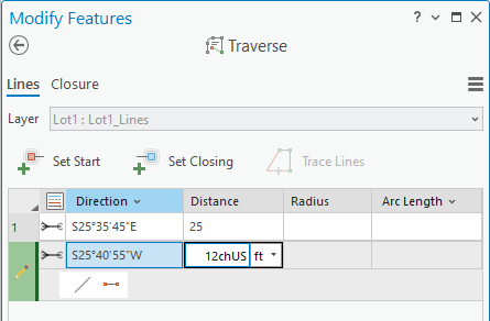

When entering dimensions in the traverse grid, you can click the unit drop-down arrow in the field to see the available unit formats for that dimension. The unit formats will include any unit formats you have added to your project.
You can temporarily change the unit format of a field by clicking the units drop-down arrow and selecting a different unit format. The dimension entered in the field will be temporarily converted to the unit format selected from the drop-down arrow. For example, typing 25 in the Distance field (that uses feet) and choosing m (Meter) from the field drop-down arrow converts 25 feet to 7.62 meters. Once focus is shifted away from the field, the dimension is set back to 25 feet.
You can also type an override character to override the unit format set for the field. For example, if the unit format of the field is feet, typing 12chUS converts 12 US chains to feet.
Tip:
Type the unit abbreviation to override the current unit format for a field.
