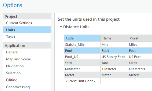

  4. Click <Select Unit Code> in the empty row and choose a unit of measurement.
    The unit of measurement is added to the table.
    Units table
