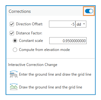

    Or, hover over the button until the pop-up dialog box appears, click the Corrections toggle button, and move the pointer back to the map.

  1. On the ribbon, click the Edit tab. In the Corrections group, click the Ground To Grid drop-down arrow .
    Alternatively, on the status bar at the bottom of the active map, hover over the Ground To Grid button until the pop-up dialog box appears.
  2. Check or uncheck the Direction Offset check box.
    Checked
    Rotate line segments by the specified value when you are using ground to grid tools.
    Unchecked
    Do not rotate line segments when you are using ground to grid tools.
  3. Click the Direction Offset drop-down arrow and set the direction units.
  4. Click the Direction Offset text box and type the offset angle for the specified units.
  5. To close the dialog box and save your settings, click the map.
  2. Check or uncheck the Distance Factor check box.
    Checked
    Scale line segments by the specified value when you are using ground to grid tools.
    Unchecked
    Do not scale line segments when you are using ground to grid tools.
  3. Click one of the following methods to configure how the distance factor value is specified.
    Constant scale
    Scale all distances by the specified scale factor. Click the text box and type a scale factor.
    Compute from elevation mode
    Compute a combined scale factor using z-values generated by the current elevation mode and the coordinate system for the active map. You can set the elevation mode to a constant z-value or set it by clicking an elevation surface using the pointer.
    Note:
    This setting computes a combined scaled factor using map projection information, and the location and elevation of the data being edited. The scale factor updates dynamically on the corrections display as you move the pointer and create features.
  4. To close the dialog box and save your settings, click the map.
