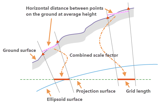

Distance factor
The distance factor is a user-defined multiplier that converts ground distances to grid distances as you create geometry. Surveyors measure ground distances between two point locations on a level two-dimensional plane at an elevation above sea level that is effectively the ellipsoidal height.
Although the distance factor is computed at a single point location for a particular deed or subdivision, for most use cases it can be applied to all line distances in the same document, as the distance factor does not vary significantly within an area that is represented in a single document.
While there is a measurable difference between ellipsoidal heights and the height above sea level, this difference is mathematically insignificant when computing a distance factor for most land record data.

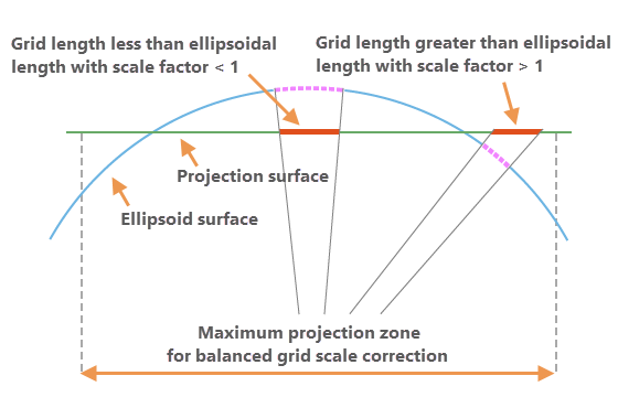

Grid scale factor
The grid scale factor converts distances between the geodetic distances on the ellipsoid surface and the grid plane of the projection. This factor is computed from the x,y location of the point and the properties of the projection surface.

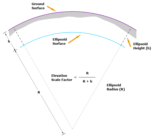

Elevation factor
The elevation factor converts distances between the geodetic distances on the ellipsoid surface and the horizontal ground distances. This factor is computed from the z-elevation of the point.
Combined scale factor
The applied distance factor value is calculated as a combined scale factor using grid scale and elevation factors. The combined scale factor is the product of multiplying the grid scale factor and the elevation factor.
These two scale factors correct the combined linear distortions caused by the curvature of the earth and the ground height of the measured distances above the ellipsoid surface with respect to the projection surface.
