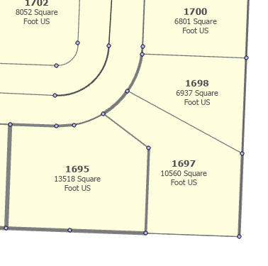

Inconsistent line
The measurement from point Sp2 is calculating coordinates that are significantly different from the other measurements.

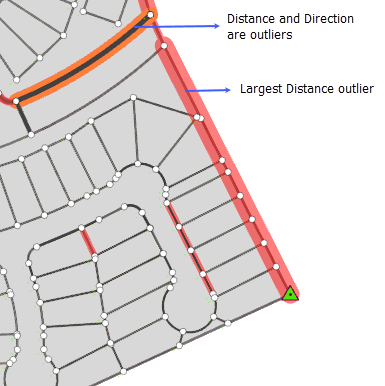

In the Adjustment Lines layer, lines with outlier dimensions are highlighted in pink for outlier distances and yellow for outlier dimensions. The larger the Standardized Student's t Statistic attribute value for the dimension, the thicker the line symbology. Dimensions with larger Standardized Student's t Statistic attributes are deviating more than expected from the best-fit solution computed by the least-squares adjustment.
Lines with dimensions flagged as outliers
A dimension is flagged as an outlier when the measurement correction between the original dimension and adjusted dimension of the line fails statistical testing against the Normal distribution at the 95 percent confidence level. A 95 percent confidence level means that 95 percent of all measurement corrections for the adjusted network are expected to be within 1.96 deviations from the mean (average) value. See a description of the Normal distribution in the section below.
Dimensions with Standardized Normal Statistic attributes that exceed +-1.96 are flagged as outliers (the Outlier field is set to Yes).

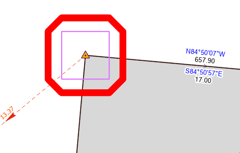

In the Adjustment Lines layer, latitude and longitude corrections are displayed in the Geodetic Latitude and Geodetic sublayers using boxes that are drawn around weighted points. Outlier corrections are displayed in red, and the larger the Standardized Student's t Statistic attribute value for the correction, the thicker the line symbology.
Latitude correction outlier
The latitude (outlier) and longitude corrections are displayed as red and pink boxes around the weighted point.

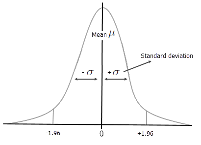

The Normal distribution, also known as the bell curve, models how measurements of a quantity are distributed. The Normal distribution expects most measurements to cluster around the mean value, which is the central peak of the curve. The probability that measurements will deviate from the mean decreases symmetrically from both sides of the curve. The larger the deviation, the smaller the expected probability.
In a Normal distribution, 95 percent of the area under the curve lies within approximately 1.96 standard deviations of the mean.
Normal distribution
The Normal distribution is based on the mean (average) and standard deviation of a measured quantity.
