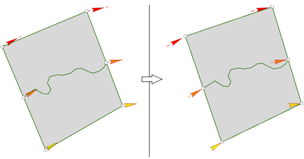

Natural boundaries in the least-squares adjustment
In the parcel fabric, a COGO-enabled line is a two-point line with COGO dimensions. A two-point line is a single, straight or curved line with a start and end point and represents most parcel boundary lines.
There are other parcel lines that represent natural boundaries in the parcel fabric and these lines are represented by polylines. Polylines are made up of line segments and vertices at the ends of each segment. The additional vertices occur at bends in the line, which represent the shape of the natural boundary.
In the least-squares adjustment, polylines representing natural boundaries are considered the same as two-point lines if the polyline has COGO attributes. The COGO attributes on a polyline represent the imaginary straight line that goes between the start and end point of the polyline. If a polyline has COGO dimensions, it will be processed in the same way as two-point lines by the least-squares adjustment.
In the graphic below, the natural boundary represented by the green line has COGO attributes that define the direction and distance between the start and end of the line.
In the least-squares adjustment, the COGO attribute values and the coordinates of the start and end points of two-point line features are used in the analysis. The adjustment does not consider the geometry of the features. When applying the adjustment results to the parcel fabric, the line geometries—including natural boundary polyline geometries—are transformed and updated using a similarity transformation.
In the graphic below, the geometry of the natural boundary between two adjacent parcels is not distorted after the results of a least-squares adjustment have been applied. The vectors show the changes in the position of the parcel fabric points, with the parcels on the right showing the updated adjustment.
Updated natural boundary after a least-squares adjustment

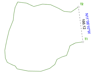

Recommendations for natural boundaries and least-squares adjustments
In some cases, the polyline geometries of natural boundaries can result in unbalanced placements of start and end points. In the graphic below, the natural boundary shape results in the short dashed line that will be used to represent the COGO attributes in the least-squares adjustment.
Natural boundary in the least-squares adjustment

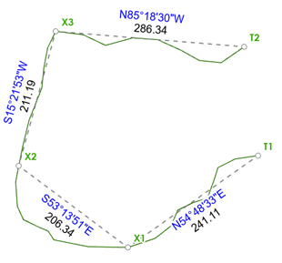

Splitting the polyline feature into separate polyline features will result in a more balanced distribution of start and end points and COGO dimensions in the least-squares adjustment. In the graphic below, the polyline geometry of the natural boundary is split at the locations of parcel fabric points X1, X2, and X3, creating four separate features and a more balanced distribution of COGO dimensions, and start and end points.
Splitting a natural boundary for the least-squares adjustment
