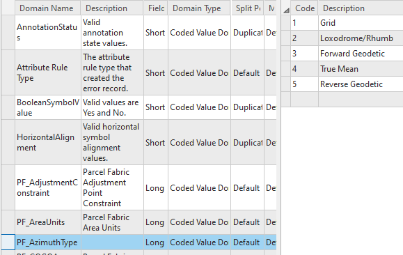

  1. Create a coded-value domain in a geodatabase for the five direction types. You can provide your own domain name and description but the Field Type attribute of the domain must be set to Long.
    Add coded values for grid, loxodrome/rhumb, forward geodetic, true mean, and reverse geodetic using the following codes: 1–Grid, 2—Loxodrome/Rhumb, 3—Forward Geodetic, 4—True Mean, and 5—Reverse Geodetic.
    Note:
    The five direction types must be assigned the coded values shown in the image below. The coded value descriptions can vary, but, for example, grid directions must be assigned a coded value of 1 and true mean directions must be assigned a coded value of 4.
    Coded-value domain for direction types

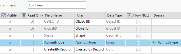

  2. Add a field named AzimuthType to the line feature classes that will use the direction types.
    The field name must be spelled and formatted AzimuthType.
  3. Set Data Type to Long and Domain to PF_AzimuthType.
    Field with PF_AzimuthType domain

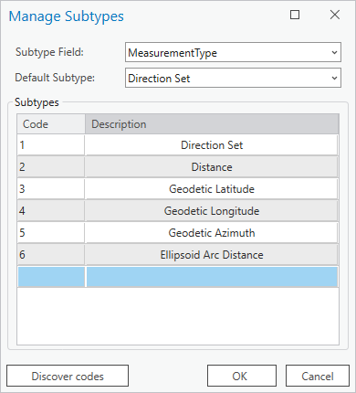

  5. If you are using a parcel fabric and use the Analyze Parcels By Least Squares Adjustment tool to run least-squares adjustments, add the following subtypes to the MeasurementType field in the AdjustmentLines analysis feature class: 5–Geodetic Azimuth, 6—Ellipsoid Arc Distance.
    To add subtypes, right-click the AdjustmentLines feature class in the Catalog pane, point to Data Design and click Subtypes. Select the MeasurementType field in the fields view, and click Create/Manage on the Subtypes tab to add the new measurement subtypes. The two new measurement subtypes must be assigned the code values shown in the image below:

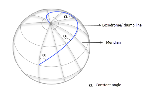

Rhumb line directions
Rhumb (or loxodrome) lines have the following characteristics:
  • They cross meridians at the same angle.
    Meridians are circular lines on the surface of the earth that have a constant longitude and are terminated by the north and south poles.
  • They have a constant bearing. The bearing does not change.
  • The bearing is measured in relation to true (astronomic) north.
  • They represent both meridians and lines of latitude.
  • On a Mercator projection, they are straight lines.
  • They are not the shortest path between two points.
Rhumb or loxodrome line

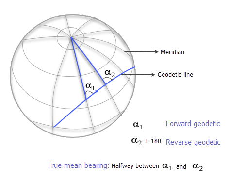

Forward, reverse, and true mean geodetic directions
Forward, reverse, and true mean geodetic directions define lines that are the shortest path between two points on an ellipsoid. The bearing of the line path is constantly changing.
Forward geodetic is the bearing of line referenced to the meridian at the start of the line. Reverse geodetic is the bearing of the line referenced to the meridian at the end of the line. True mean is the bearing of the line at its midpoint, which is halfway between the forward and reverse geodetic bearings.
When defining parcel boundaries, geodetic directions are typically reserved for very long parcel lines.
Forward geodetic, reverse geodetic, and true mean
