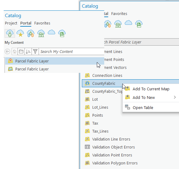

Add the parcel fabric to a map from a portal
The parcel fabric is a controller dataset, and the parcel fabric group layer should be added as a stand-alone layer to the map. Parcel fabric functionality is not available if any of the parcel fabric layers is grouped with other layers in the Contents pane.
To add the parcel fabric to a map from a portal, follow these steps:
  1. In the Catalog pane, on the Portal tab, locate and double-click the published parcel fabric feature layer to display the parcel fabric and its feature classes.
  2. Right-click the parcel fabric layer and click Add To New Map to add the parcel fabric and its associated layers to the map.
    Add the parcel fabric and its layers to the map from your portal
    You can also add the parcel fabric to a current map view or drag the parcel fabric onto the map.
    Note:
    You do not need to manually add the associated layers to the map. When you add the parcel fabric to a map, associated layers are automatically added.
  3. On the Adding parcel fabric layer dialog box, click OK to add the parcel fabric layers as Editing layers.
    When a parcel fabric resides on the portal, it already has been published and cannot be added as publication layers.
