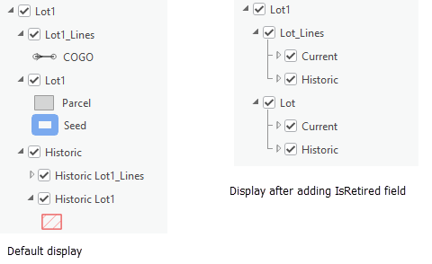

Use subtypes
Historic and current parcels can also be displayed using a system-defined subtype. Using subtypes allows historic parcels to have different topology rules from current parcels.
Learn more about the parcel fabric topology
When using a system-defined subtype, the default layer organization for parcel types can be changed to display parcels using the subtype. The subtype can be configured by adding an IsRetired field on both the parcel polygons and parcel lines of the parcel type and then by adding the two subtype codes described in the steps below.
The graphic below shows parcel type group layer Lot1 displayed with the default layer organization and then displayed with the IsRetired field subtype.
Displaying historic parcels
To display parcel layers using current and historic subtypes, complete the following steps:
  1. Add a field named IsRetired (type Long) to both the parcel type polygon and line feature class.
  2. Add the following subtypes to the IsRetired field:
    • Code: 0, Name: Current
      The code 0 is for current parcels, which have a null RetiredByRecord field. The subtype name can be changed.
    • Code: 1, Name: Historic
      The code 1 is for historic parcels, which have a populated RetiredByRecord field. The subtype name can changed.
  3. Populate the IsRetired field with the subtype codes.
    The default layer configuration for parcel types separates current parcels from historic parcels using sublayers.
    1. After adding the IsRetired field, use field calculation to populate the field with 0 for the current parcel polygon and line sublayers.
    2. Use field calculation to populate the field on the historic parcel polygon and line sublayers with 1.
  4. Add the parcel fabric to a new map for the updated historic layer settings to display in the Contents pane and in the map.
