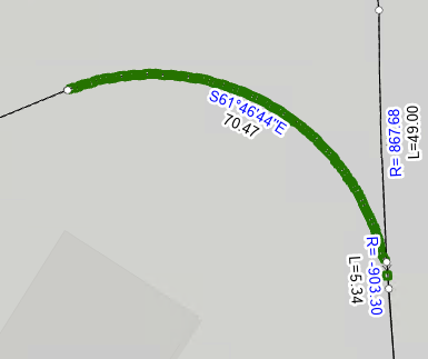

Line Vertices
The Line Vertices layer displays lines from the referenced layer with vertices. These are the same vertices that appear when using the Edit Vertices tool to edit feature vertices. In the Line Vertices layer, however, vertices are only symbolized if they do not occur at the start or endpoints of the referenced lines.
You can use the Line Vertices layer to detect curves defined by polylines (densified curves). Densified curves are composed of a series of small line segments that form a single, curved polyline.
Vertices on a densified curve
The Line Vertices layer displays vertices on densified curves.
Remove vertices
The Simplify By Straight Lines And Circular Arcs tool can be used to reduce the number of line segments and the number of vertices in polygon and line features. The tool replaces consecutive line segments or polygon edges with fewer line segments or edges. Densified curves can be replaced with true curves.
Densified curves should be replaced with true curves for performance and data editing purposes.
