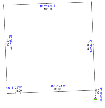

Create a parcel traverse with a connection from a point-of-beginning
On some records, the starting location of a parcel is defined as being at the endpoint of a connection line that connects from a known point or point-of-beginning.
Parcel traverse with point-of-beginning
The parcel traverse starts with a connection from a known point-of-beginning.
To create a parcel traverse that starts with a connection from a point-of-beginning, follow these steps:
  1. In the Modify Features pane with the Traverse tool open, click the Layer drop-down box and choose the parcel fabric connection lines layer.
  2. Click Set Start and click to snap on the point-of-beginning.
  3. Click in the Direction field to start entering the dimensions of your connection lines.
    The connection from the point of beginning to the parcel can consist of multiple courses.
  4. After entering an open traverse of connection lines, click New at the bottom of the Modify Features pane to start a new traverse for the parcel.
    The start location of the traverse is automatically set to the end point of the previous traverse, which in this case is the connection lines traverse.
  5. In the new traverse, click the Layer drop-down box and choose the parcel line feature layer for the closed loop parcel traverse.
  6. Click in the Direction field and continue entering the dimensions for the new parcel.

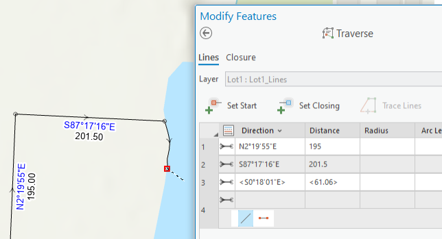

Create a parcel traverse with a natural boundary
The boundaries of parcels can follow natural features such as rivers or coastlines. In these cases, the traverse line is digitized as a polyline along the natural boundary and dimensions are not entered.
To create a parcel traverse that has a natural boundary, follow these steps:
  1. Follow the steps above to create a record and start entering a new parcel traverse.
  2. To digitize a natural boundary for a traverse course, click the Line tool beneath the traverse grid and digitise a single polyline.
  3. When the digitized polyline is complete, right-click in the map and click Finish to create the traverse course.
    A single row is created in the traverse grid containing dimensions for the straight line that goes between the start point and end point of the digitized polyline. These generated dimensions are displayed in angle brackets, for example, <S3°27'16"W> and <64.15>
    Parcel traverse with a natural boundary
  4. To continue entering regular traverse courses after a natural boundary course, click the 2-Point Line tool beneath the traverse grid and continue entering traverse dimensions.
    The 2-Point Line tool ensures that single, two-point COGO-enabled line features are created for non-natural boundary traverse courses.
