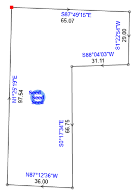

When seeds are created for loops of overlapping lines, the seed is labeled in the map. In the image below, three seeds have been created for three overlapping loops of lines. Each loop of lines represents a floor level and their FloorOrder field has been populated with the same floor level number.
