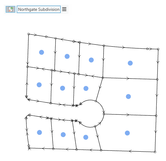

Parcel seeds
When you use the Copy Lines To tool to copy lines to the active record, parcel seeds are automatically created for closed loops.
A parcel seed is the initial state, or seed state, of a parcel. A parcel seed indicates to the build process that a parcel can be built from the lines enclosing the seed.
Learn more about parcel seeds
When copying lines from the parcel fabric, you can select a parcel to copy its boundary lines, or you can select individual parcel lines or connection lines. When you select a parcel to copy its lines, you have the option to preserve and transfer the attributes of the selected parcel to the seed that will be generated for the surrounding boundary lines.
After lines have been copied to the active record, you can add, delete, or edit the lines to construct new parcels. Parcel seeds can be copied and pasted to new closed loops, or they can be regenerated. To regenerate seeds, click Create Seeds in the Construct group on the Parcel Record Workflows tab. Copy and paste a parcel seed if you want to preserve the attributes of the seed.

Copy lines to the active record
To copy lines from selected parcels or selected lines to the active record, follow these steps:
  1. Set a parcel record as active in the map. If the record does not exist, create one.
    The active record is displayed in the record's heads-up display (HUD) box in the map extent.
  2. If you're selecting parcels to copy their boundary lines, use the Select tool to select the parcels. The parcels' corresponding boundary lines will be copied to the active record. If you're copying individual parcel lines, use the Select tool and selection chip to select parcel lines.
  3. Click the Copy Lines To tool in the Construct group on the Parcel Record Workflows tab.
  4. On the Copy Lines To dialog box, choose a parcel type to which to add the copied lines. If you want to copy individual lines as connection lines, choose Connection Lines.
  5. Choose Show only active record to show only parcel features that are part of the active parcel record.
    Turning off the display of parcel features that are not part of the active record is useful when editing and modifying lines to construct new parcels.
    Note:
    If parcels are already part of the active record, these parcels will be displayed in addition to the copied lines.
  6. If you're selecting parcels to copy their boundary lines, choose Preserve attributes if you want to transfer the attributes of the selected parcels to the parcel seeds that will be generated for closed loops of parcel lines.
    Note:
    This option is only available if you selected parcels to copy their lines.
  7. Click OK to copy the lines and add them as new lines to the active record.
    Seeds will automatically be generated for closed loops of lines. If you chose to preserve attributes, parcel seeds will be populated with the selected parcels' attributes. To view the attributes of a parcel seed, select the seed and click Attributes in the Selection group on the Parcel Record Workflows tab to open the Attributes pane.
  8. Add, delete, or edit lines to construct new parcels. Copy the existing parcel seed into new parcel loops, or click Create Seeds in the Construct group on the Parcel Record Workflows tab to generate parcel seeds.
  9. After new parcels have been constructed and seeds have been added, click Build Active in the Construct group on the Parcel Record Workflows tab to build parcels in the active record.
