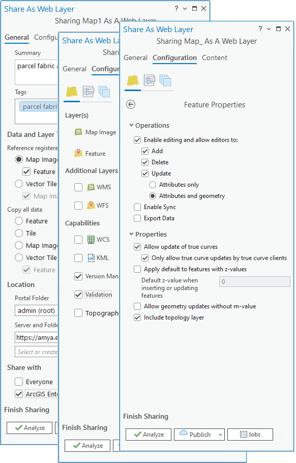

  3. On the Share As Web Layer dialog box, on the General tab , add a web layer name, a summary, and tags.
  4. Under Data and Layer Type, choose Map Image, and check the Feature check box under Reference registered data.
  5. Under Location, choose where the data will be shared under Portal Folder.
    You can share the data to the root folder or create a folder.
  6. Under Sharing Level, specify how the parcel fabric will be shared, and choose a group if applicable.
  7. On the Configuration tab, under the Configure Layers icon , select Version Management and Validation under Capabilities.
    Note:
    • The Version Management and Validation options are not available if the feature dataset containing the parcel fabric is not branch versioned. Confirm that the parcel fabric has been added to the map from a branch-versioned database connection.
    • The Validation option enables topology and attribute rule validation on the parcel fabric when it's published as a feature service.
    • You can publish the parcel fabric as read-only without version management and validation.
    Share As Web Layer dialog box with General and Configuration tab settings
    The parcel fabric layer can be published as a feature service that is consumed through the ArcGIS Pro client.
  8. On the Configuration tab, under Layers, click the Configure Web Layer Properties button next to Feature to open Feature Properties, and ensure that Include topology layer is checked.
    The topology layer must be published with the parcel fabric
  9. If you are publishing the parcel fabric as a feature service for offline use, check Enable sync under Operations, and choose a Version Creation option under the Sync drop-down arrow.
    See the Publish the parcel fabric as a feature service for offline editing section below for more information about taking a parcel fabric offline for editing.
  10. Click Analyze to identify potential issues or errors.
    Two types of analyzer messages appear on the Messages tab. Errors are issues that must be fixed before you can publish web layers. Warnings are issues in which performance, appearance, or data access may be affected. Double-click the error or warning for a solution or access to a help topic. Right-click the error or warning for suggestions on how to address the issue.

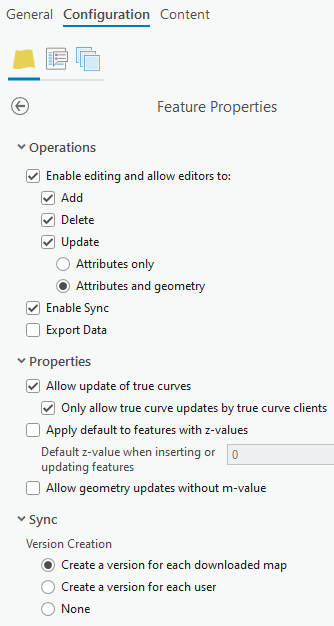

Parcel fabric web layers can be added to a map that can be taken offline for editing. A parcel fabric must be published as a sync-enabled, editable feature service. Both editing and sync must be enabled on the Configuration tab in the Feature Properties pane on the Share As Web Layer dialog box.
Feature Properties pane settings
When taking a map offline, data in web layers that support synchronization is downloaded to a local geodatabase in the project home folder and is available for offline editing. After edits are complete, data is synchronized with the enterprise geodatabase.
When branch versioning is used to manage multiuser edits, as is the case with the parcel fabric, the data can either be synchronized with the default version or synchronized with a replica version. When editing a parcel fabric offline, it is recommended that you review edits and run quality checks on the offline edited data before making it available to others. In this workflow, offline editors synchronize edits with a replica version, which can be reviewed for quality before being reconciled and posted to the default version.
When publishing a parcel fabric for offline use, choose Create a version for each downloaded map for Version Creation under the Sync drop-down arrow to review edits and synchronize with a replica version.
