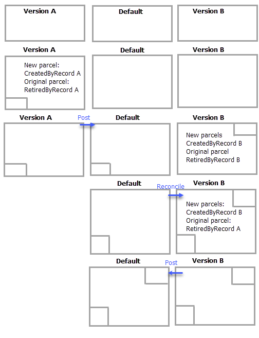

Parcel record conflicts occur when the same parcel is retired by different records on different versions. This scenario can occur when a parcel is edited in different versions (in record-driven workflows) and the original parcel is retired by two different parcel records. This results in an incorrect parcel lineage. When reconciling, if parcel record updates have been posted to a parcel from previous versions, there will be record conflicts and parcel geometry conflicts as shown in the graphic below.
Resolving parcel conflicts (described in the Resolve parcel conflicts section below) will correct the parcel lineage and update the parcel geometry on the version being reconciled.

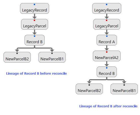

In the above graphic, resolving parcel conflicts after reconciling Version B will update the parcel geometry with the geometry updates posted from Version A. The parcel lineage of record B will be updated to reflect the lineage changes from record A, shown in the graphics below:
Parcel lineage conflict resolution

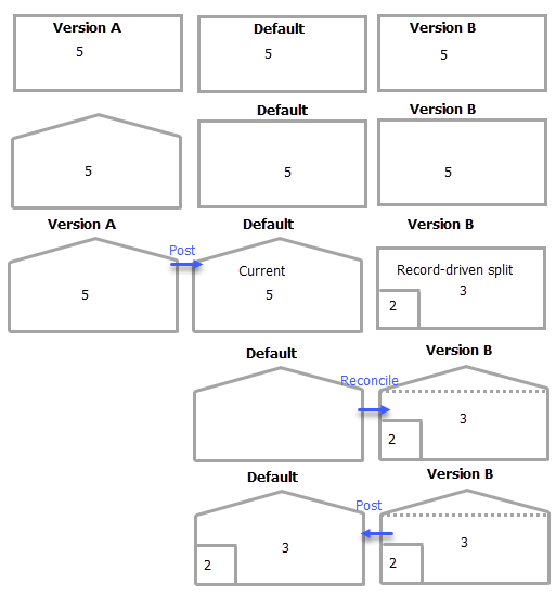

Parcel record and geometry conflicts occur when a parcel polygon or line geometry is updated in a quality-driven workflow and posted from a version, while the same parcel is being edited on a different version. This scenario can occur when a record-driven workflow is performed on a parcel in a version, while a data quality-based geometry update is made to the same parcel in a different version and posted to default.
Parcel geometry conflict resolution
For example, in the graphic above, the following edits have occurred:
  • In Version A, a quality-driven geometry update is made to parcel 5 and posted to the default. No parcel record was used.
  • In Version B, a record-driven split is performed on parcel 5 to create parcels 2 and 3. Parcel 5 is retired as historic.
  • After Version B reconciles, resolving parcel conflicts (described in the Resolve parcel conflicts section below) will update the geometry of parcel 3.
  • During conflict resolution, the northern-most line of parcel 3 is replaced with the deleted version of the line from default (using the Conflicts pane).
  • Two historic parcels are created: The original parcel 5 on Version B and the updated geometry of the original parcel 5. Both historic parcels are retired by the record that created parcels 2 and 3.
During parcel conflict resolution, you can also choose which attributes are written to the final version of the polygon or line features in conflict. These are the attributes as they appear on the features in conflict rather than the features in the database. For example, in the above graphic, the Name attribute could have been modified on both parcel 5 in Version A and parcel 3 on Version B. You can choose which attribute to use for the final version of the feature.
