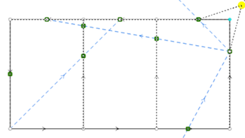

When the segments of different features intersect with parcel lines, vertices are introduced into the line geometry when a topology is validated. These extra vertices do not immediately change the shape of the parcel line, however the line shape may be impacted by these vertices when subsequent edits are performed.
For example, in the graphic below, vertices are added at the intersection of parcel lines and connection lines when the topology is validated. If a parcel point is moved and parcel edge topology has not been enforced, vertices can result in bends in the line shape geometries shown in the graphic below:

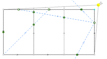

When parcel edge topology is enforced, vertices existing on two-point lines or curves that do not correspond with parcel fabric points are ignored. These vertices will not result in two point lines or curves being bent when a parcel fabric point is moved. Lines and curves will maintain their collinearity shown in the graphic below:

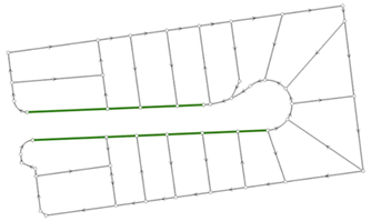

Parcel boundary lines are often tangent to each other when they connect at a common endpoint and represent a common edge. And example of tangent straight lines would be road frontage boundary lines shown in the graphic below:

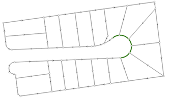

Curved lines are tangent to each other when representing road features such as cul-de-sacs shown in the graphic below:
When moving a point with parcel edge topology enabled, straight lines that are tangent to each other will move together and remain tangent, and similarly, tangent curves will remain tangent.
