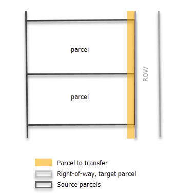

Transfer a parcel from multiple source parcels to a single target parcel
An example of a transfer from multiple source parcels to a single target parcel is when a right-of-way is widened and cuts into the adjacent parcels. In the United States, this is called a right-of-way dedication. This type of transfer also commonly occurs when an easement parcel cuts through multiple parcels for a utility line or railway line.
Note:
In this type of transfer, the transfer parcel must be perpendicular to the source parcels.
In the image below, a road is widened, clipping the areas of the adjacent parcels.
Transfer a parcel to widen a road.
When a parcel is transferred from multiple source parcels to a single target parcel, parcel data is updated as follows:
  • The source parcels are retired as historic by the record of the transfer.
  • New source parcels are created with smaller areas. The area of the transfer parcel is clipped from the shapes of the source parcels.
  • The target parcel is retired as historic by the record of the transfer.
  • A new target parcel is created with a larger area. The area of the transfer parcel is merged with the shape of the target parcel.
  • The transfer parcel is not retired as historic or removed. It remains active.
  • The shape of the target parcel is extended in the same direction as the direction of its existing boundary lines.
  • The shapes of the source parcels are clipped in the same direction as the direction of their existing boundary lines.
  • The Stated Area attributes on the new source and target parcels reflect the updated areas.

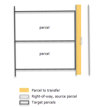

Transfer a parcel from a single source parcel to multiple target parcels
An example of a transfer from a single source parcel to multiple target parcels is when a right-of-way is vacated. The right-of way is eliminated completely where the area is transferred from the right-of-way to the adjacent parcels. In the United States, this is called a right-of-way vacation.
Note:
In this type of transfer, the transfer parcel must be perpendicular to the target parcels.
In the image below, the road is vacated to the eastern parcels (the western half of the road will be vacated to the adjacent western parcels). The road area is transferred to and merged with the adjacent parcels, which become larger.
Transfer a parcel to vacate a road.
When a parcel is transferred from a single source parcel to multiple target parcels, parcel data is updated as follows:
  • The source parcel is retired as historic by the record of the transfer.
  • The target parcels are retired as historic by the record of the transfer.
  • New target parcels are created with larger, merged areas. The area of the transfer parcel is merged with the target parcels.
  • The Stated Area attributes on the new target parcels reflect the updated areas.
  • The shapes of the target parcels are extended in the same direction as the direction of their existing boundary lines.
