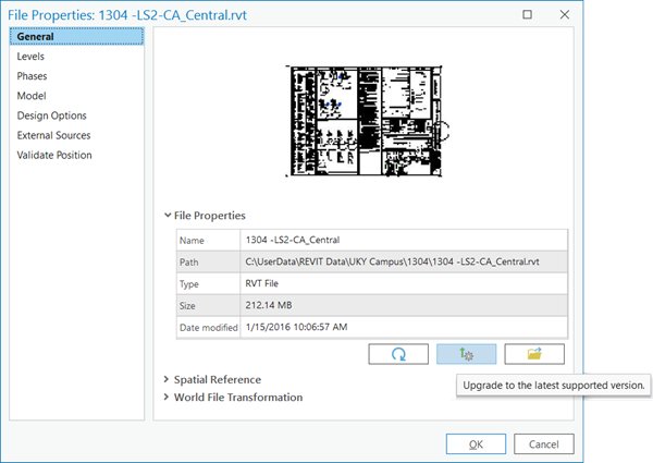

ArcGIS Pro converts the contents of the Revit file to conform to the newest file format in memory before it reads the contents. To avoid this step each time you open an existing Revit file, you can save the RVT file as the most recent Revit file version that ArcGIS Pro supports. To upgrade to the latest version, click the upgrade to latest supported version button on the general tab of the BIM file properties dialog box initiated from a right-click of the properties option in the Catalog pane.
Permanently upgrade the version format of an
Note:
Choosing to upgrade to the latest supported version permanently changes the file, and it cannot be undone.
Note:
Opening an RVT file in Autodesk Revit software that has been upgraded to the latest version in ArcGIS Pro produces a message that it was last saved by an application other than Autodesk Revit.

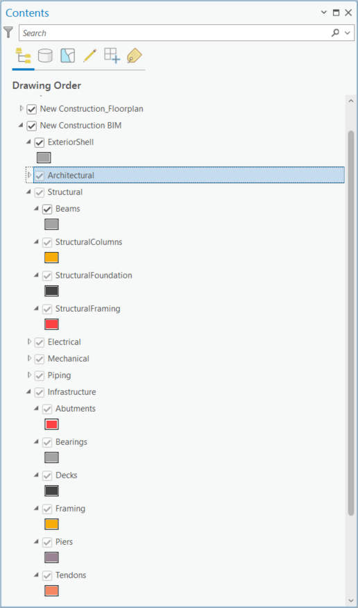

Adding the entire BIM file workspace representing the Revit or IFC file to an ArcGIS Pro scene creates an ArcGIS Pro building layer and a standard ArcGIS Pro group layer containing the feature layers for the feature classes in the Floorplan dataset. Initial support for IFC files does not include the floor plan information. Feature data for bridges in Revit may be included in both the Structural and Infrastructure discipline layers. Various infrastructure layers such as railways are included in the infrastructure discipline. By default, the ExteriorShell feature layer, which represents the entire structure as a single feature, is visible by default. The building discipline layers containing the individual BIM building element categories as feature layers are hidden by default. You will need to turn on these discipline layers to see all of the content.
Point and linear feature classes in a BIM file workspace are not automatically included in the resultant building layer when the entire BIM file workspace is added to a scene. You can add these point and line feature layers from the BIM file workspace individually to a scene and then drag them into a building layer in the TOC.
Building layer with expanded feature layer
The feature layers are organized within the discipline layers based on industry convention. The feature layers themselves may also be symbolized based on the types of systems included.

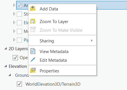

You can access the context menu of the discipline layers by right-clicking them. These commands allow you to access capabilities specific to the collection of feature layers within the discipline. Add Data, for example, allows you to add a feature class as a feature layer to the specific discipline layer. Feature layers added to a building layer must be from the same BIM file workspace (same BIM file), or if the building layer is based on a geodatabase, it must be from the same geodatabase dataset. You can rename and remove building discipline layers, but you cannot add a new one.
Discipline layer context menu
