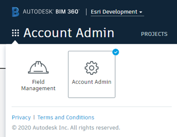

  1. As the Autodesk BIM 360 administrator, sign in to BIM 360.
  2. From the Module Selector, choose the Account Admin option.
    Autodesk BIM 360 Account Admin user interface

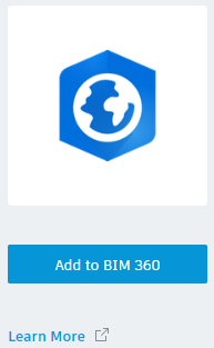

  4. Choose the thumbnail image for ArcGIS Pro on the Feature Apps page.
    ArcGIS Pro App store tile
  5. Click the Add to BIM 360 button on the ArcGIS Pro app page.
    Add ArcGIS Pro to BIM 360 option

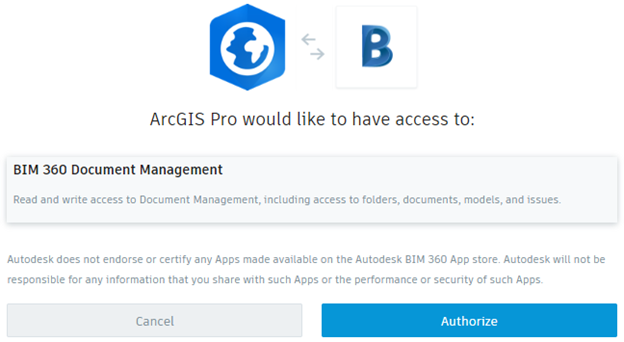

  6. Click the Authorize button in the pop-up window that appears. Check the Document Management access option, and click the Next button.
    Authorize ArcGIS Pro app in BIM 360
