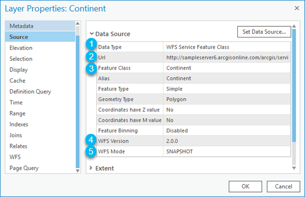

Read-only properties of the WFS layer
The following WFS layer properties provide more information about the WFS server connection properties. These properties are located on the Source tab of the Layer Properties dialog box.
The WFS layer data source properties such as the URL, WFS version, and WFS mode
  1. Data Type—If you are connected to a WFS layer, this property tells you that the data type is a WFS Service Feature Class.
  2. Url—This is the URL for the WFS service.
  3. WFS Version—The version of WFS that you are connected to. In this example, the version is 2.0.0.
  4. WFS Mode—This is the connection mode you are using. In this example, the connection mode is snapshot.

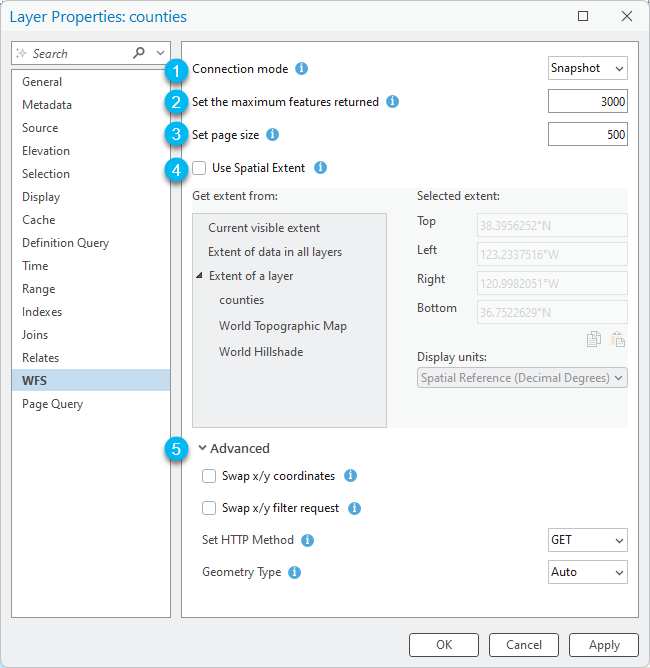

There are a number of WFS layer properties that you can modify if needed:
WFS layer properties such as the connection mode, axis order, or maximum number of features returned
  1. Connection mode—This property allows you to choose the connection mode for your layer. By default, the connection mode is snapshot.
    Connection mode
    Description
    Snapshot
    This mode is compatible with most WFS services. When using this mode, a temporary copy of the WFS data is downloaded and used like a cache of features. Instead of sending complicated filter requests to the WFS service and waiting for a response from the server, you work with a copy of the data locally. When you close your ArcGIS Pro session, the temporary copy of the data is removed.
    A drawback to this approach is that you do not see edits you make to the WFS service during your ArcGIS Pro session. To see updates to the WFS service, you must close and reopen ArcGIS Pro. Using this mode, you may notice that the first time you open the layer in the map, it is slow. This is because the data is being copied from the server.
    On demand
    This mode is less compatible with most WFS services. When using this mode, you do not copy data locally and instead connect to the live WFS service. This mode sends a request to the service as you pan and zoom around the map or make queries on the data. Layers may open faster since the data is not being downloaded, and you see edits to the WFS service as they are made.
    One drawback to this mode is that it is not compatible with WFS services that cannot handle complex filter requests. To work with this layer in ArcGIS Pro and perform queries and analysis on the data, the server must support advanced filter requests.
    Another drawback is that time properties cannot be altered in this mode because time is inherited from the settings on the server.
    This mode uses the feature service's feature cache functionality to improve performance by using a display cache when the feature cache is turned on.
    You can choose whether ArcGIS Pro sends requests to the service using GET or POST requests by setting the Set HTTP Method property.
  2. Set the maximum features returned—This property allows you to limit the number of features that are added to the map. If there are millions of records in the WFS layer, working with this layer may be slow. To avoid performance issues, the default value is set to 3,000 features.
    Note:
    For the default value to be honored, the WFS service must support COUNT in version 2.0.0, or MAXFEATURES in previous versions.
  3. Set page size—For WFS 2.0 services that support paging, you can set the number of features to be returned per load request from the server. If you set this value when adding the WFS layer to the map, you can modify the value on this dialog box. Modifying the value refreshes the layer.
  4. Use Spatial Extent—Limit the number of features by providing an area of interest (spatial extent). If you set this value when adding the WFS layer to the map, you can modify the value on this dialog box. Modifying the value refreshes the layer.
    • Checked—Limit the features added to the map by providing an extent. The WFS service must support the BBOX parameter to use this functionality. Provide the extent to use in the Selected extent parameter.
    • Unchecked—Do not spatially limit the features added to the map. This is the default.
    Selected extent—Set a custom extent to use to limit the data added to the map. You can enter the coordinates manually or use values from the current visible extent, the extent of data in all layers, the extent of a specific layer. If you set this value when adding the WFS layer to the map, you can modify the extent value on this dialog box. Modifying the value refreshes the layer.
  5. Advanced—Expand this section to set additional WFS properties.
    • Swap x/y coordinates—Swap the x,y coordinates for the display of the layer.
      • Checked—Swap the order of x,y.
      • Unchecked—Do not swap the order of x,y. This is the default.
    • Swap x/y filter request—Swap the x,y coordinates for spatial filter requests sent to the server. If you need to swap the x,y coordinates for the layer to display correctly, you probably also need to swap the x,y filter requests to ensure that the results of spatial queries are correct.
      • Checked—Swap the order of x,y for filter requests.
      • Unchecked—Do not swap the order of x,y for filter requests. This is the default.
    • Set HTTP Method—Specify the HTTP method to use when sending requests to the server in on-demand mode. By default, ArcGIS Pro sends POST requests to the server in on-demand mode. This allows for more advanced filters to be sent to the server. However, some implementations of WFS do not support POST requests. In this case, you can set the HTTP method to GET and access basic functionality of the WFS layer in on-demand mode.
      • GET—Send requests to the server using the HTTP GET method.
      • POST—Send requests to the server using the HTTP POST method. This is the default.
    • Geometry Type—Specify the geometry type for the layer. By default, the geometry type is set to Auto. This means that ArcGIS Pro discovers the geometry type by querying the geometry field of the first feature in the service layer. If you know that the service layer contains mixed geometry (for example, the table contains rows with both lines and polygons), you can choose a geometry type from the drop-down menu to force the layer to display features in the data that conform to the geometry type chosen. ArcGIS Pro WFS layers are limited to one geometry type per layer. To display multiple geometry types from the same service layer, add the service layer multiple times and specify a geometry type for each layer. The Geometry Type parameter is only applicable to snapshot mode.
    • Set HTTP Timeout—Specify a time-out value in seconds for processing a server request. If no value is set, the default value is 15 seconds. Use this setting if you get persistent data loading time-outs even after adjusting the maximum number of features returned and the page size. The Set HTTP Timeout parameter is available with both snapshot and on-demand mode, but using snapshot mode is recommended.
