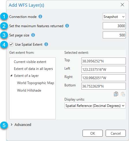

Use the Add WFS Layer(s) dialog box
The Add WFS Layer(s) dialog box allows you to set some of the optional layer properties that are available for WFS layers. This includes the connection mode, maximum feature count, page size, spatial extent limit, and advanced properties. You can also modify these properties on the Layer Properties dialog box for the WFS layer.
  1. Connection mode—Specify which connection mode to use for the layer. By default, the connection mode is snapshot.
    • Snapshot—This mode is compatible with most WFS services. When using this mode, a temporary copy of the WFS data is downloaded locally.
    • On demand—This mode is less compatible with some WFS services that do not support advanced filters. When using this mode, data is not downloaded locally and instead connects to the live WFS service. This mode sends a request to the service as you pan and zoom around the map or make queries to the data. Optionally, you can set the Set HTTP Method in the Advanced options to send requests to the server using the HTTP GET method if your server does not support advanced filters using the default POST method.
      Learn more about WFS connection mode
  2. Set the maximum features returned—Set the total number of features to be added to the map. Adding a very large dataset to the map can cause performance issues and slowness. This option allows you to limit the number of features that are added to the map. If used with the Use Spatial Extent parameter, this limits the number of features within the extent provided.
  3. Set page size—For WFS 2.0 services that support paging, you can set the number of features to be returned per load request from the server. For a WFS GetFeature request, this sets the count parameter value that is used in conjunction with the startIndex parameter for paging requests. ArcGIS Pro tries to determine the best page size to use based on your service settings; however, the optimal value may depend on the performance of the server to return features before reaching a time-out. (The default is approximately 15 seconds.) For example, servers that can return 25,000 features before timing out see a much faster map loading time if the page size is set to 25000. This decreases the total requests sent to the server from the client. However, some less performant servers may only be able to return, for example, 200 features before time-out. In this case, a low value for page size is needed to avoid loading errors due to time-out, and you see an increase in requests sent to the server to load data.
  4. Use Spatial Extent—Choose to limit features by providing an area of interest (spatial extent).
    • Checked—Limit the features added to the map by providing an extent. The WFS service must support the BBOX parameter to use this functionality. Provide the extent to use in the Selected extent parameter.
    • Unchecked—Do not spatially limit the features added to the map. This is the default.
    Selected extent—Set a custom extent to use to limit the data added to the map. You can enter the coordinates manually or use values from the current visible extent, the extent of data in all layers, or the extent of a specific layer. This property is unavailable unless you check the Use Spatial Extent check box.
  5. Advanced—Expand this section to set additional WFS properties.
    • Swap x/y coordinates—Swap the x,y coordinates for the display of the layer.
      • TRUE—Swap the order of x,y.
      • FALSE—Do not swap the order of x,y. This is the default.
    • Swap x/y filter request—Swap the x,y coordinates for the display of the layer.
      • TRUE—Swap the order of x,y for filter requests.
      • FALSE—Do not swap the order of x,y for filter requests. This is the default.
    • Set HTTP Method—Specify the HTTP method to use when sending requests to the server in on-demand mode. By default, ArcGIS Pro sends POST requests to the server in on-demand mode. This allows for more advanced filters to be sent to the server. However, some implementations of WFS do not support POST requests. In this case, you can set the HTTP method to GET and access basic functionality of the WFS layer in on-demand mode.
      • GET—Send requests to the server using the HTTP GET method.
      • POST—Send requests to the server using the HTTP POST method. This is the default.
    • Geometry Type—Specify the geometry type for the layer. By default, the geometry type is set to Auto. This means that ArcGIS Pro discovers the geometry type by querying the geometry field of the first feature in the service layer. If you know that the service layer contains mixed geometry (for example, the table contains rows with both lines and polygons), you can choose a geometry type from the drop-down menu to force the layer to display features in the data that conform to the geometry type chosen. ArcGIS Pro WFS layers are limited to one geometry type per layer. To display multiple geometry types from the same service layer, add the service layer multiple times and specify a geometry type for each layer. The Geometry Type parameter is only applicable to snapshot mode.
    • Set HTTP Timeout—Specify a time-out value in seconds for processing a server request. If no value is set, the default value is 15 seconds. Use this setting if you get persistent data loading time-outs even after adjusting the maximum number of features returned and the page size. The Set HTTP Timeout parameter is available with both snapshot and on-demand mode, but using snapshot mode is recommended.
The properties on the Add WFS Layer(s) dialog box are also available to view or modify on the WFS tab of the Layer Properties dialog box.

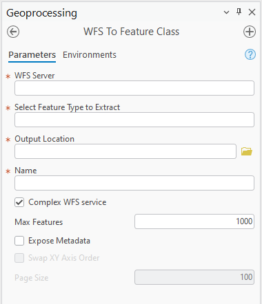

Use the WFS To Feature Class tool
You can use the WFS To Feature Class geoprocessing tool to download data from a WFS service into a geodatabase. The tool allows you to script downloading WFS data and supports complex WFS services.
To use the tool to download data from a complex WFS service, complete the following steps:
  1. Open the WFS To Feature Class geoprocessing tool.
    You can open the tool by navigating to it in the Geoprocessing pane, in the Conversion toolbox, in the From WFS toolset, or you can search for it by name in the search box.
    The WFS To Feature Class tool dialog box appears.
    The WFS To Feature Class geoprocessing tool dialog box
  2. If the WFS service is a complex service, check the Complex WFS service check box.
  3. Paste or type the URL of the WFS service in the WFS Server parameter and click outside the parameter text box.
    For example, http://gisserver.example.com/geoserver/ows?
    This populates the Select Feature Type to Extract parameter with a list of available layers to download.
  4. Select a layer from the drop-down menu.
  5. Provide a location for the download using the Output Location parameter.
    If Complex WFS service is checked, the output is a file geodatabase, so the location must be a folder.
    If Complex WFS service is unchecked, the output is a feature class, so the location must be a geodatabase or a feature dataset in a geodatabase.
  6. Provide a name for the output feature class or geodatabase in the Name parameter.
  7. Optionally, enter a value for the Max Features parameter to limit the number of features returned.
  8. Optionally, if Complex WFS service is checked, expose the service metadata by checking the Expose Metadata parameter, which creates and populates metadata tables in the output geodatabase.
  9. Optionally, to limit the features to an area of interest, provide an extent value for the Processing Extent parameter on the Environments tab.
    Alternatively, set the arcpy.env.extent environment if using Python when running the tool.
To automate this process in a Python script, you can find code samples in the tool documentation.
