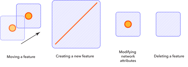

A dirty area is represented by a purple translucent polygon and tracks the extent of the edited feature, the type of edit, the global ID of the feature, and the editor who performed the edit. If a feature's geometry is modified, two dirty areas are generated for the single feature. One represents the envelope of the feature's previous geometry, and the other represents the feature's new geometry.
Operations that create dirty areas
Modifications to the following create dirty areas:
Geometry
Fields that are defined as network attributes
Error features that are created when you enable or validate the network topology will result in dirty areas.
