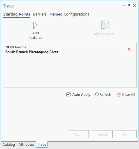

In the Trace pane, two options are available for setting starting points and barriers. You can use the Add features option to manually select network features on a map, or you can use the Add selected option to set preselected network features on a map as starting points. The steps below demonstrate these options.
Trace pane with Starting Points tab active

You can manually select network features on a map to set them as starting points or barriers. Complete the steps below if the features you want to set as trace locations are not selected on the map. This workflow uses the default setting in the Trace pane, with Auto Apply checked.
  1. On the Trace Network tab, in the Tools group, click Trace to open the Trace pane.
    You can set the active tab in the pane to be Starting Points or Barriers .
  2. In the Trace pane, confirm that the Starting Points or Barriers tab is active.
  3. In the Trace pane, confirm that Auto Apply is checked.
  4. With the Add features option active, click a network feature on the map.
    You can place a starting point or barrier on a network feature, a point feature, anywhere along a line feature, and on a polygon feature.
    • A green circle appears where you clicked to represent a starting point.
    • A red x appears where you clicked to represent a barrier.
A temporary feature is added to the Starting Points or Barriers tab in the Trace pane for use in a trace. Because Auto Apply is on, the point is automatically committed as a starting point or barrier for a trace. Starting points and barriers use the TN_Temp_Starting_Points or TN_Temp_Barriers temporary feature class, respectively, to store these features in the project's default geodatabase.
To place additional starting points or barriers, continue clicking other network features. To clear the trace locations, click the delete button next to each feature in the pane, or click Clear All to remove all features set as starting points or barriers on the tab.
