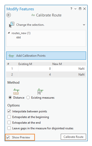

  3. Click the Calibrate Route tool in the Modify Features pane.
    To find the tool, expand the Route category, or type Route in the Search text box.
  4. To preview the calibrated route on the map before you create it, check the Show Preview check box.
    Show Preview

  6. Click Add Calibration Points in the pane and click a minimum of two points sequentially along the route in a route-increasing or route-decreasing order.
    The existing m-values appear in the properties table.
  7. Type the new m-values in the properties table in each corresponding control point field.
  8. Choose one of the following calibration methods in the Method section.
    Distance Distance
    Recalculate the measures using the shortest path distance between the calibration points.
    Existing Measures Existing measures
    Recalculate the measures using the preexisting measure distance between the calibration points.
  9. Configure any combination of the following optional settings:
    Interpolate between points
    Interpolate the values between the calibration points.
    Extrapolate at the beginning
    Extrapolates before the calibration points.
    Extrapolate at the end
    Extrapolate after the calibration points.
    Ignore spatial gaps
    Measure values are recalculated as continuous for disjointed routes.
