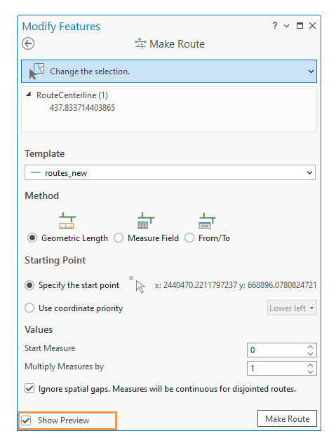

  3. Click the Make Route tool in the Modify Features pane.
    To find the tool, expand the Route category, or type Route in the Search text box.
  4. To preview the route on the map before you create it, check the Show Preview check box.
    Make Route Show Preview check box
  5. Click Select , and select the line features with geometry you want to copy and make the route.
    To add more features to the selection, press the Shift key and click the features.
    The selected features appear highlighted.
  6. Click the Template drop-down arrow and choose a target m-aware feature template.
  7. Click Specify the start point in the Starting Point section of the tool pane, click the Start point tool, and click the endpoint of the selected line feature from which you want the route to start and m-values to be calculated.
    Alternatively, click Use coordinate priority and choose lower left, lower right, upper left, or upper right to allow the tool to determine the endpoint closest to the selected coordinate priority.
  8. To calculate measure values from the length of the selected features in the target layer's coordinate system, click Geometric Length and configure the following settings in the Values section of the pane:

  11. Click Make Route.
    The route is created and is the current selection.
