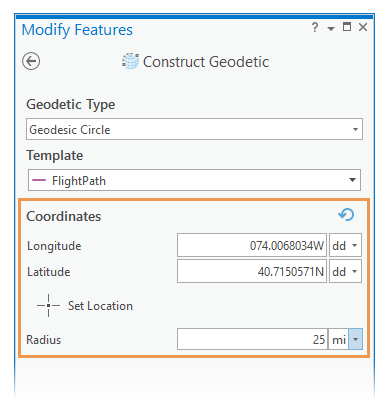

  8. If you set the tool to create a Geodesic Circle geodetic feature, complete the following steps:
    1. In the Coordinates section, choose a unit format and type the coordinate value for each coordinate parameter.
      Alternatively, click Set Location and click the map to specify the coordinates using the pointer.
    2. Click the Radius box, choose a unit format and type the radius value.
    To reset your values, click Reset .
    Construct geodetic circle
    The unit format determines the parameters that appear in the pane.

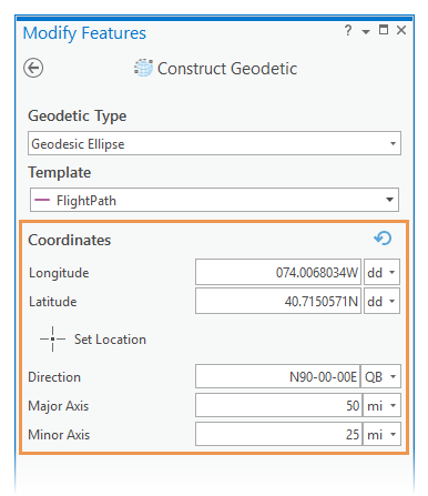

  9. If you set the tool to create a Geodesic Ellipse geodetic feature, complete the following steps:
    2. Click the Direction box, choose a unit format and type the direction value.
    3. Click the Major Axis box, choose a unit format and type a numeric distance value.
    4. Click the Minor Axis box, choose a unit format and type a numeric distance value.
    Construct geodetic ellipse
