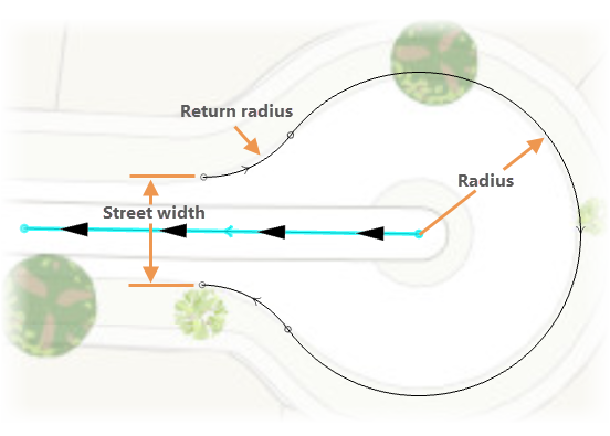

In the Modify Features pane, the Cul-de-sac tool creates cul-de-sac geometry that is aligned with a selected line feature representing the centerline of a road. You specify the street width, a radius value for the cul-de-sac, and a radius value for the two return curves.
You can select straight- or curved-line features. Selecting a centerline with a 90-degree turn creates an asymmetrical cul-de-sac. The return (or reverse) curves terminate both ends of the main arc at the specified street width.

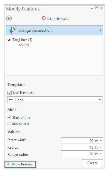

  5. Show the tool and turn on the preview.
    1. In the pane, expand COGO and click Cul-de-sac .
    2. Check Show Preview.
      Cul-de-sac tool

  7. To create the cul-de-sac on a layer that is different from the selected feature layer, do the following:
    1. Check Use Template.
    2. Click the drop-down arrow and choose a feature template.
  8. Choose the end of the selected line feature at which you want to create the cul-de-sac.
    • Start of line—Creates the cul-de-sac at the first vertex.
    • End of line—Creates the cul-de-sac at the last vertex.
  9. Specify the width and radial parameters for the cul-de-sac.
    • Street width—The distance at which both ends of the main arc terminate.
    • Radius—The main arc of the cul-de-sac.
    • Return radius—The return curves that terminate both ends of the main arc at the street width.
  10. Click Create.
