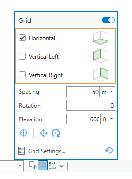

Use the grid in a 3D scene
Complete the following steps to use the grid in a 3D scene:
  1. Configure your snapping preferences.
    In the following steps, you can snap the grid origin and rotation angle to existing feature geometry.
  2. Click Grid on the status bar and enable the grid.
    Grid
    Alternatively, hover over it until the Grid pop-up menu appears and click the Grid toggle button .
  3. Hover over Grid on the status bar.
    The Grid pop-up menu appears.
  4. Check the Horizontal check box and, optionally, the Vertical Left or Vertical Right check box to enable the vertical grid.
    3D grids
  5. Click the Spacing box, provide a grid distance, and choose a unit format.
  6. Click the Rotation box, provide a rotation value, and press the Enter key.
    To rotate the grid on-screen, click the Set Rotation tool . Move the pointer, and click the map or snap to a feature. To cancel the tool, press the Esc key or click Cancel on the toolbar.
    The grid rotates around the grid origin. If the grid origin is not set for the current edit session, the origin is set to the center of the current map extent.
  7. Click the Elevation text box, and type a grid elevation and choose the units.
  8. Click the Set Origin tool , move the pointer to move the grid and the map, or snap to a feature.
    Caution:
    This also changes the elevation.
  9. Move the pointer back to the scene view and proceed to create or modify features.
