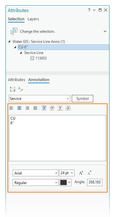

    The text string appears in the text window.
  7. Click the formatting buttons above and below the text window to change the formatting.
    Alternatively, enclose the text within starting and ending text text formatting tags, for example <BOL> CU 6" </BOL>. Any unrecognized balanced tag pair is ignored by the parser.

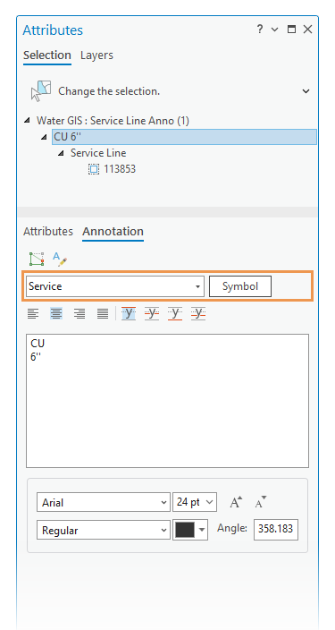

  6. Click the Symbol drop-down arrow and choose an annotation symbol defined by the feature class.
    Alternatively, to choose a symbol that is not defined with the feature class, click Symbol, click the Gallery tab, and choose a symbol.
    Attributes pane
    The annotation symbol is applied to the annotation feature.
  7. If the Auto Apply check box is not checked, click the Apply button to apply the changes.

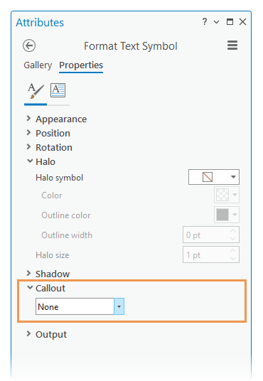

  5. Click Symbol, and click the Properties tab.
  6. To add a background, click Callout, click the Callout symbol drop-down arrow, and choose Background.
    Note:
    Adding a background callout preserves the reference to the text symbol.
  7. To add a halo, expand Halo, click the Halo symbol drop-down arrow and choose the halo symbol.
    Note:
    Adding a halo disconnects the reference and causes all symbol properties to be stored in line with the feature.
    Format Text Symbol pane
  8. Click Apply to apply the changes.
