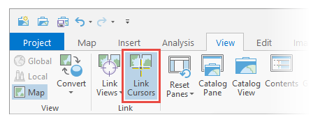

  2. On the ribbon, click the View tab. In the Link group, click Link Cursors .
    Link Cursors

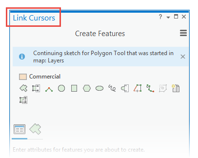

  5. In the Create Features pane, click a polyline or polygon feature template and create at least two segments.
  6. Click another map view and continue sketching the feature.
    Link Cursors appears at the top of the pane and a message reports the name of the map view where the tool was started.
