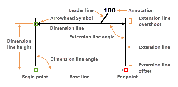

Dimensions are annotation features with additional geometry. The elements of a dimension are illustrated in the following diagram:
Dimension elements
