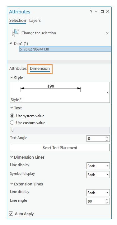

  4. Click the Dimension tab.
    Dimension tab in the Attributes pane
  5. To change the dimension style, expand the Style section, click the drop-down arrow and choose the dimension style.
  6. To customize the selected dimension style, expand one or more of the sections and make the changes described in the following table:

  7. If Auto Apply is not checked, click the Apply button.
