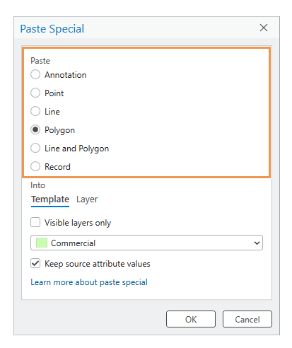

    The Paste Special dialog box appears.
  6. If the clipboard contains a mix of feature types or records from a table, choose the feature type you are pasting.
    If the clipboard contains only one feature type, these options are not available.
    Paste Special feature choices
