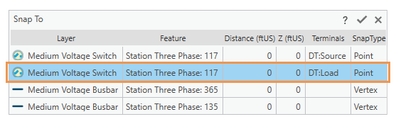

    The Snap To pop-up window appears.
  7. Click the row for the target feature in the Snap To pop-up window.
    Note:
    • To cancel the selection and snap to the default feature, click the Discard button , or press Esc. This action closes the Snap To pop-up window.
    • To close the Snap Chip and continue sketching the feature, click the map.
    A circle flashes at the target snap location for the selected feature.
  8. Click the Apply button in the Snap To pop-up window, or double-click the row.
