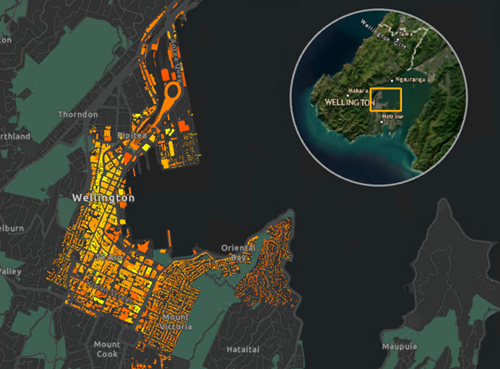

A layout showing a detailed view of a Wellington neighborhood and a smaller-scale overview map frame with a rectangular extent indicator locating the extent of the neighborhood map
The orange rectangle in the circular map frame is an extent indicator. The extent indicator shows what area is being displayed in the larger map frame.
