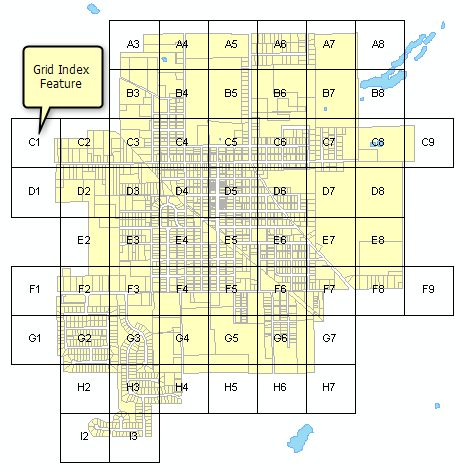

Grid index map series
For detailed maps representing large areas, you can break the area up into smaller map extents and create a layout for each smaller extent. A grid can divide the larger extent so the area is covered without overlapping. You can then use the grid as the index feature for the map series. The Grid Index Features tool can be used to automatically generate a grid over a given area.
Grid index feature example

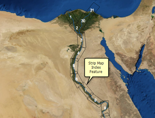

Strip map series
A set of map pages that follow a line feature—such as a river, road, or pipeline—is called a strip map series. Each page of the map series shows a defined geographic area on either side of the line feature with subsequent pages showing areas farther along the line. Often, there is some geographic overlap between adjacent map pages. The Strip Map Index Features tool automatically generates a strip map grid over a given linear feature.
Strip index feature example
