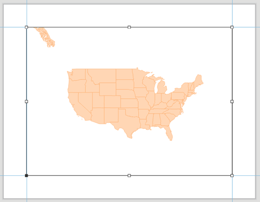

  5. On the Insert tab, in the Map Frames group, click the Map Frame drop-down menu and choose the map in your project.
  6. In the layout view, click and drag to create the map frame inside the guides as shown in the following image:
    Layout with guides displaying the map frame
